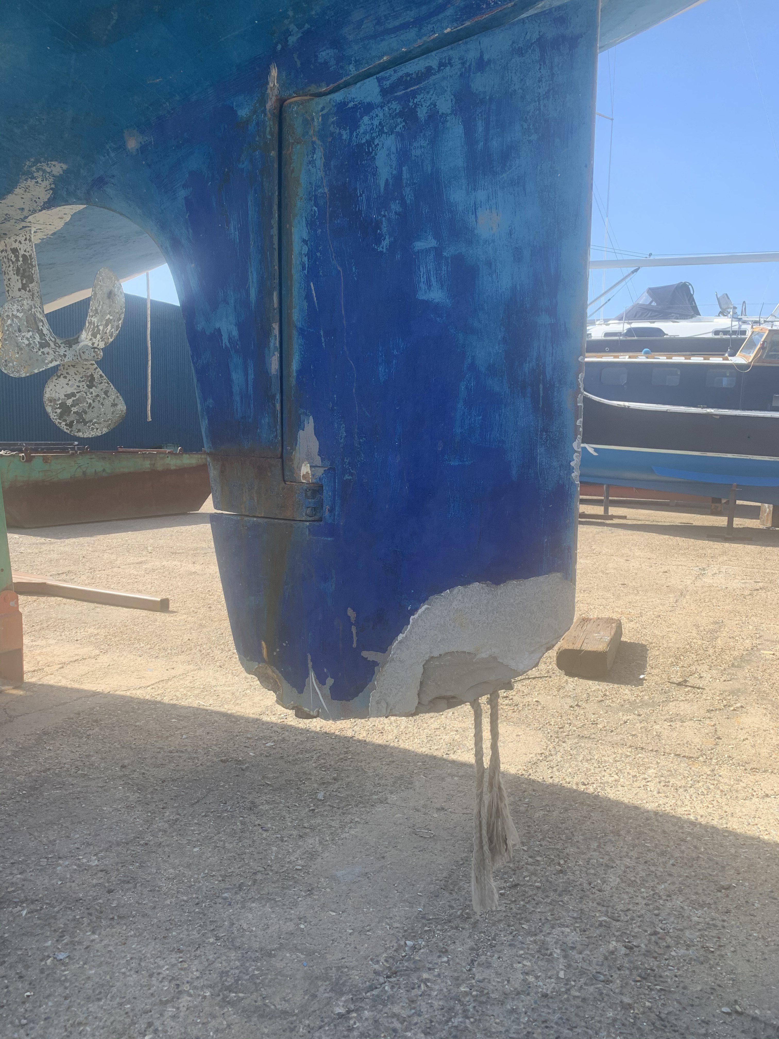

If your considering purchase of a hull that has been submerged for any length of time, you need to think of the consequences for the structure and rig. Was she pounded on the bottom after her sinking? If so, how is her keel attachment and the grp keel stub to which the keel is secured? How is her rudder? How is her skeg (to which the foot of the rudder is attached? How about structural timber components in the hull, e.g. chainplate attachment part bulkheads, mast compression post attachments?
I think I know a fair bit about boat building, but I wouldn't take on a project like that without engaging a professional marine surveyor or a shipwright who I knew to be reliable to give her a thorough survey before purchase.

She wasn't fully submerged but on her side on the rocky beach. Skeg looks in one piece (photo attached) but rudder will need some work on it/replacing.
Do you/anyone on here know anyone they'd recommend for such work?
