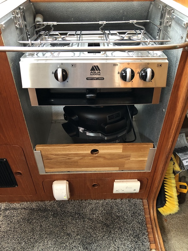

We replaced the cooker with a hob/grill and a Ninja electric cooker. Did think about alcohol, but Domestic stopped making the Origo range and a good friend did warn me of sooty pans with alcohol.
Teak and holly floors would have been an optional extra. Keep the carpet if you like sailing all year round. They keep the boat warm in the winter and nice to walk on in the evenings. We have none slip carpet mats.
