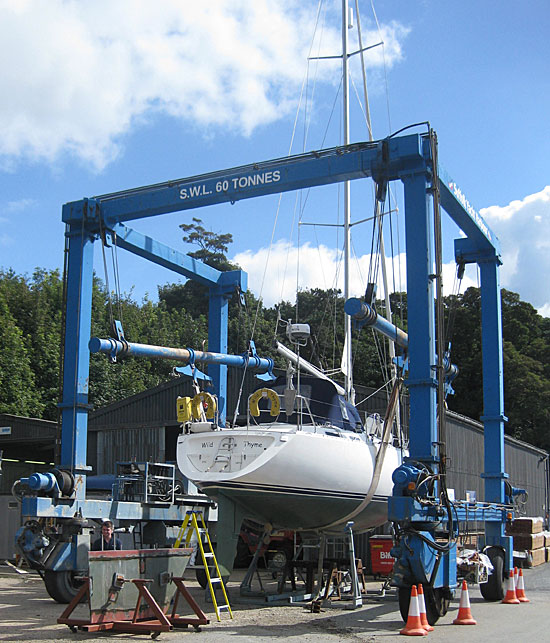

we did have the keel dropped and the joint remade on Wild Thyme in 2014, not because it was desparately needed, but because we were replacing the engine and, one of the keel studs on the Moody 425 is almost inaccessible with the engine in place and the one small patch of rust appearing in our 2 year old Coppercoat was at the keel / hull joint. To do this job, you need to remember that, when sat in a cradle, most of the weight of a yacht sits on the keel - the props are just to stop her falling over. You also need to be aware that the keel weighs tons ( 2.04 in the case of a Moody 34) so you need a good means of supporting both boat and keel while they are separated.
It didn't take me long to decide this is a job for the yard. They supported the boat in a travel hoist and handled the keel in a purpose built jig on wheels built for just this sort of job. We chose 316 stainless for the new studs, nuts and backing plates, the old studs came out looking perfect below the exposed part and there was little migration of the rust on the top keel face inwards, so it would have lasted many years more. However, since then, no more rust has appeared at the keel / hull joint.
I attach a couple of small photos the yard took when her keel was off:

Out of interest - did they have to keep you in the slings of the lift for the duration of the work or did they find an alternative way to support the hull? Many thanks.

We hit lucky there, the yard had just bought a new bigger travel hoist and the old one was about to be sold on, but was still there, so they chose to leave her hanging in the old hoist while the keel was cleaned up the sides re-Coppercoated (it's red when it has just been applied) at the top, the new studs fitted, then the keel refitted. About 2 days work, so normally the hoist could not be spared for such a period, and the hull would be sat down on the keel stub while the keel is worked on. A travel hoist is ideal for lifting a boat on or off her keel - you tend to get less swinging around than on a crane so it's much easier to line the studs up with their holes. You might think it easier to lift the keel up and down, but that requires another structure to hold the hull up in the air while it's got no keel to sit on.
