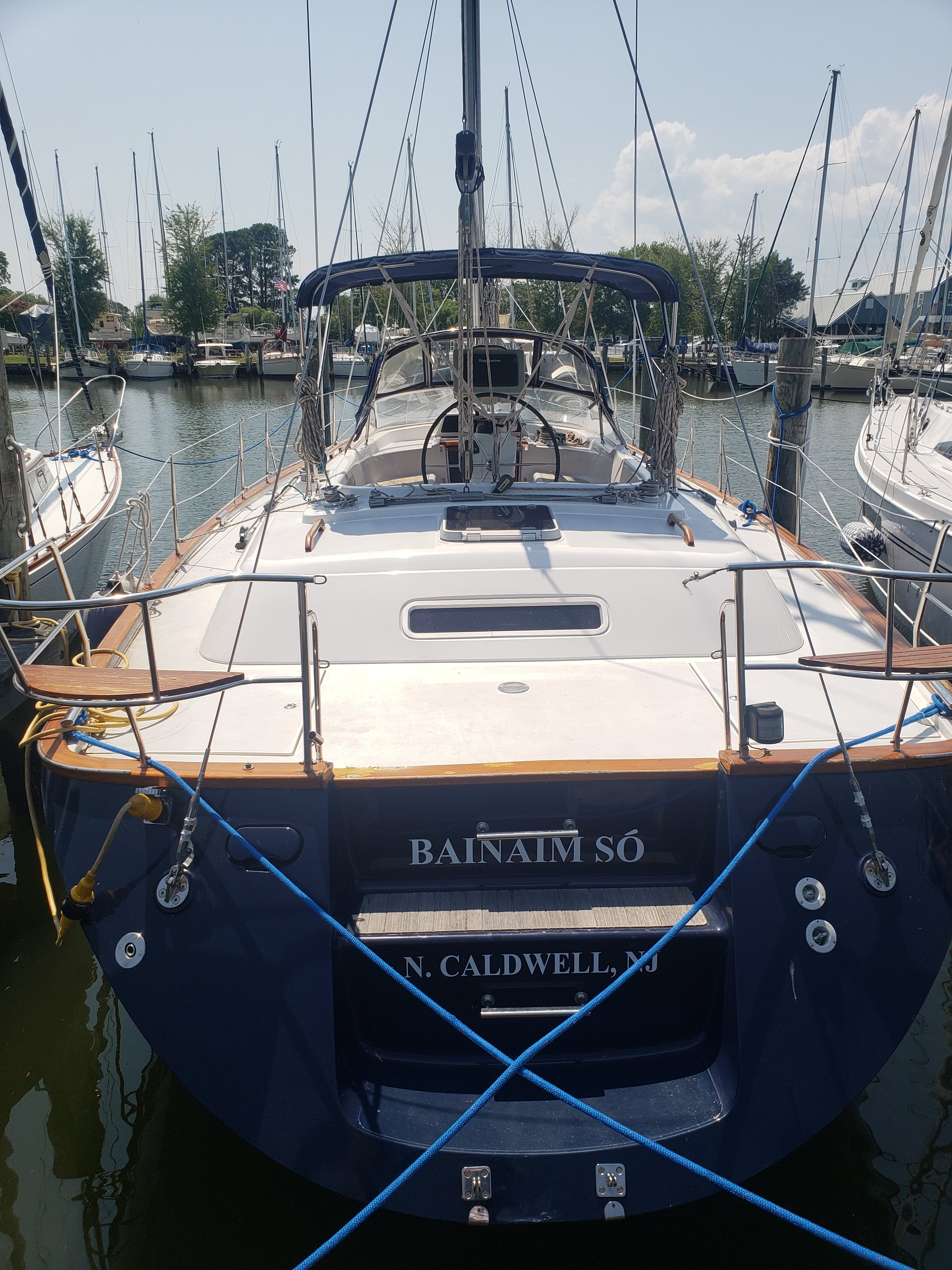

Roy, the boat I looked at has an Irish name, I think!, Do you know what the name means?
Sorry Greg, I have no idea what it means.
Roy
PS - I did not sail the Atlantic in my M42, I sailed the sky in a 747!!
