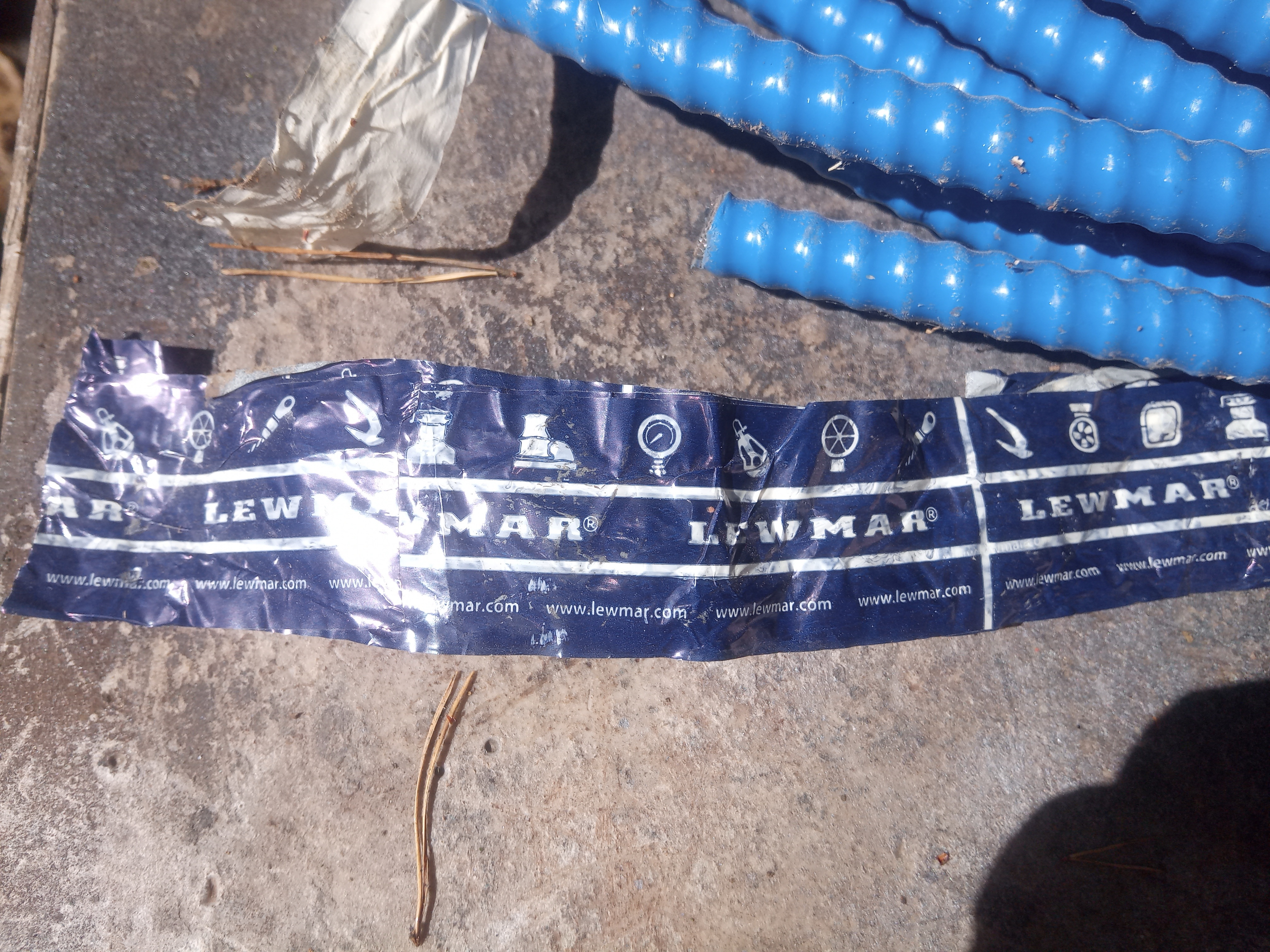

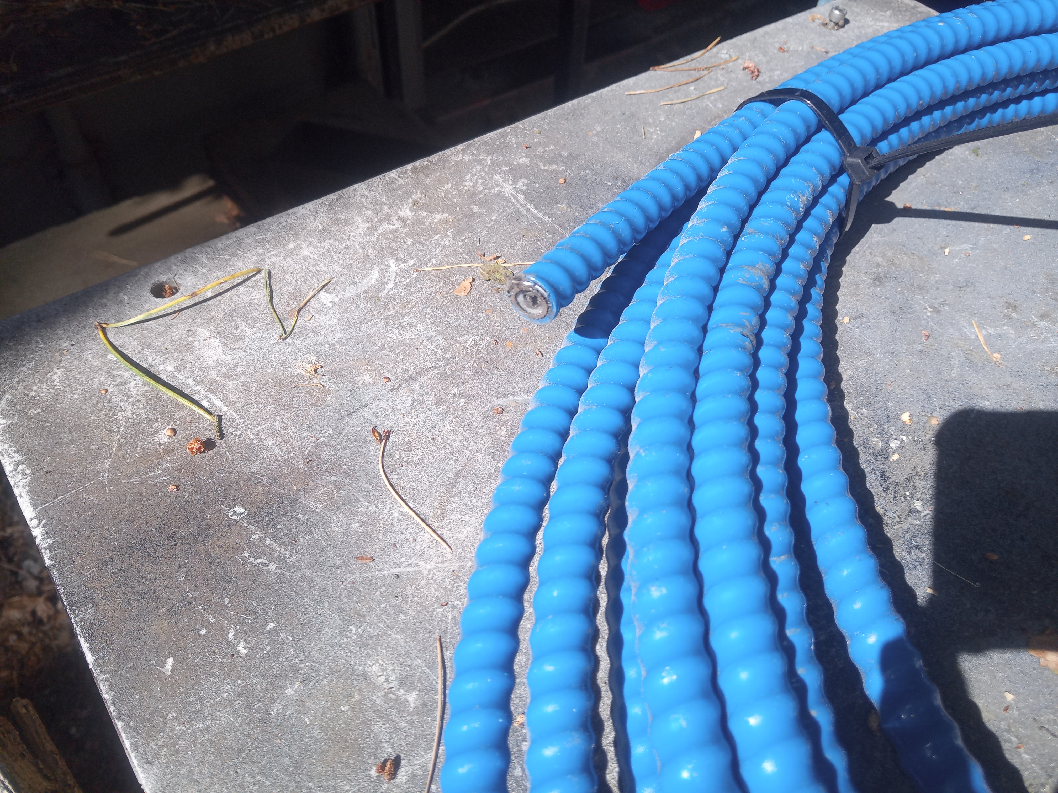

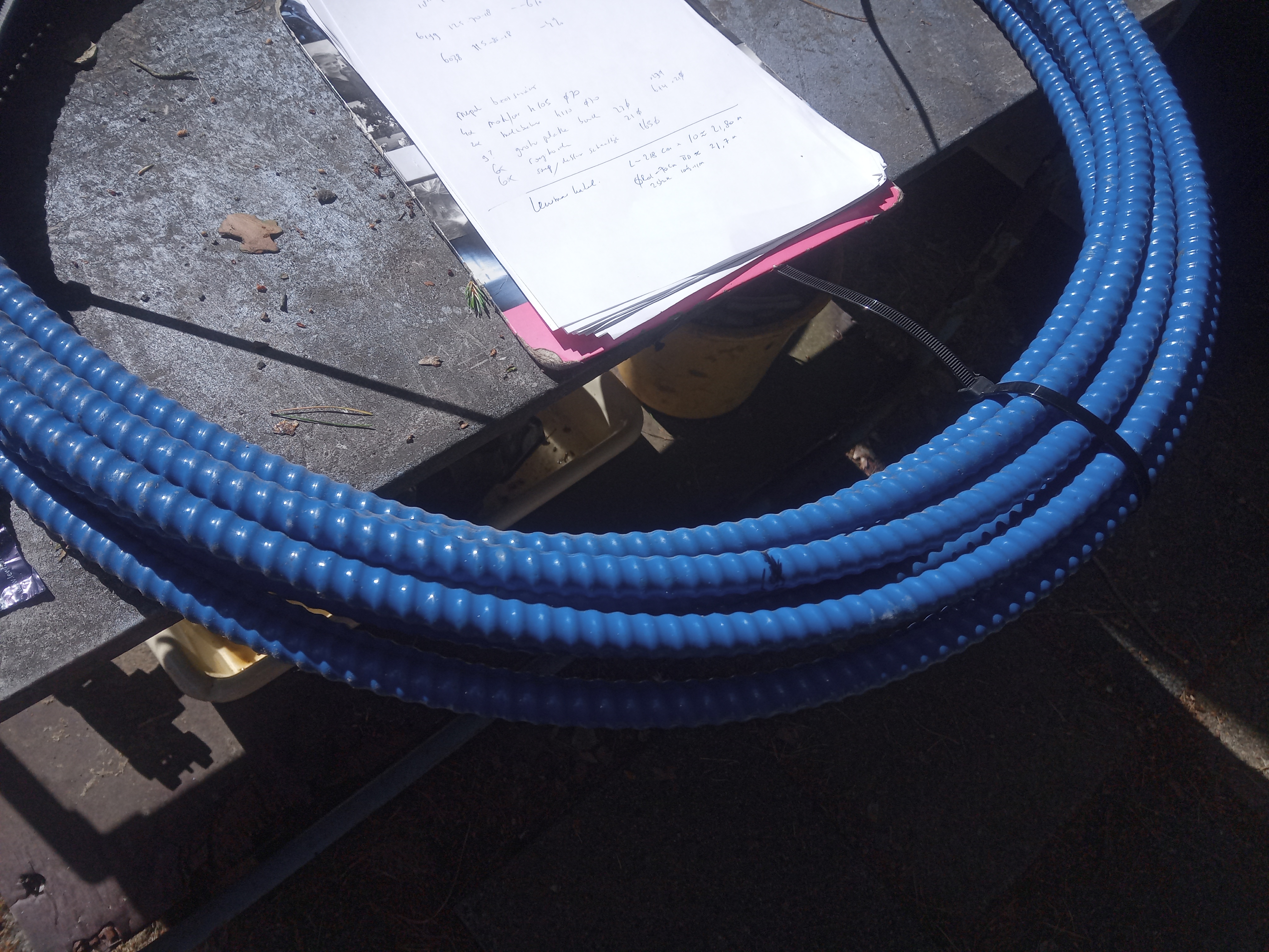

For Sale LEWMAR Conduit-Blue, steering tube, new, still 21m available
Erik de Lange
Erik De Lange
MIRA
Vlissingen
English Channel, Belgian & Dutch coasts

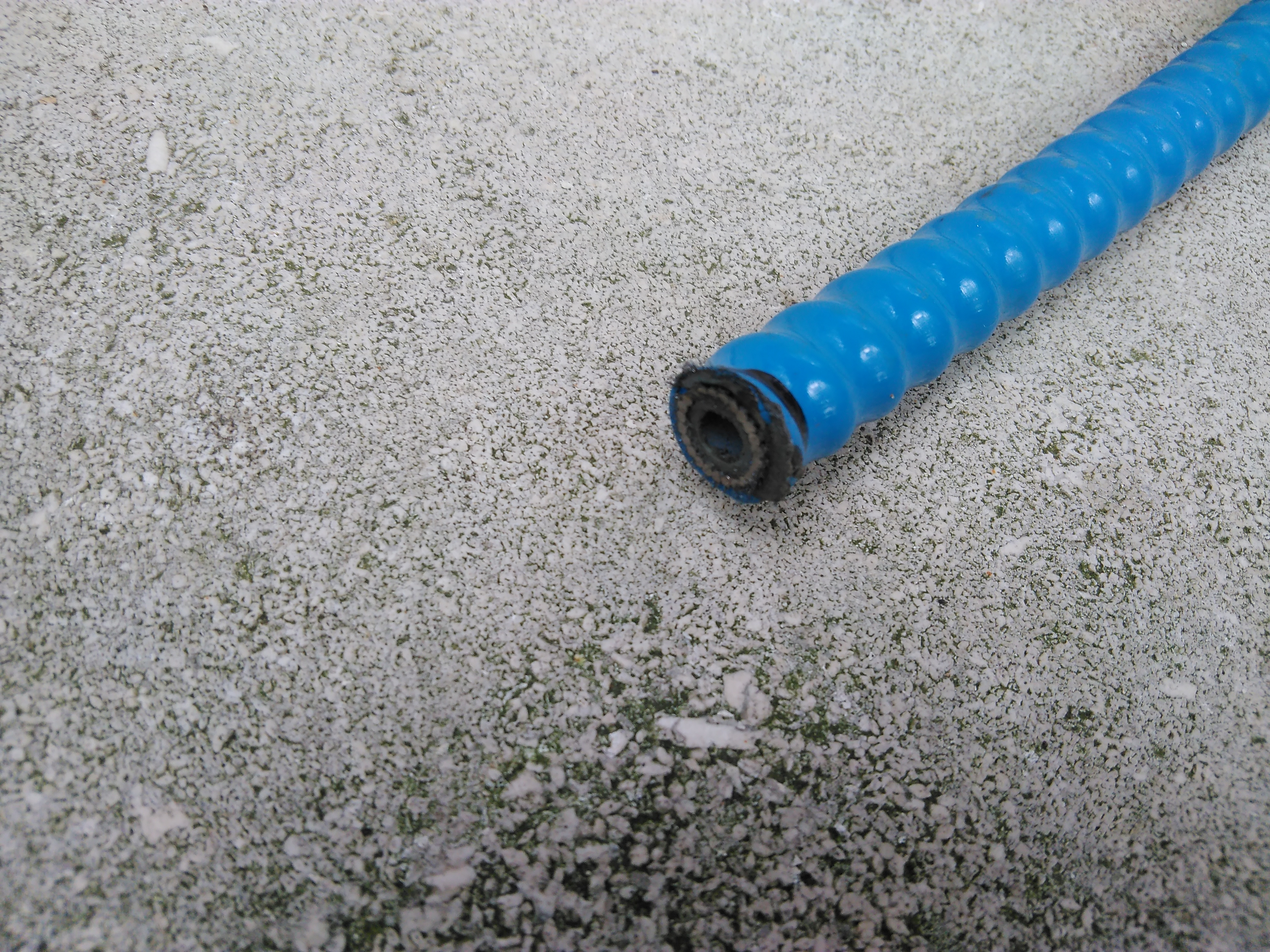

The original Lewmar Conduit blue
New and unused, ordered too much length a couple of years ago.
Lewmar nr 89100069 16mmØ
suitable for 5mmØ and 6mmØ steel steering cable ( not included).
I still have 21m available.
Typical length needed for a center cockpit Moody is 2x 4 to 5m. (e.g. M376 2x4m).
I would be prepared to cut it in half, making length for 2 boats, 2x 10m roughly.
Usual internet price is a little over 41€ or 34 pounds/m, I propose a 30% discount at 29€ or 25 pounds.
Shipping would be from the EU, so please sort out import duties before, in case delivery would be in the UK or elsewhere outside the EU.
Could be collected in Belgium , The Netherlands or Britanny North Coast.

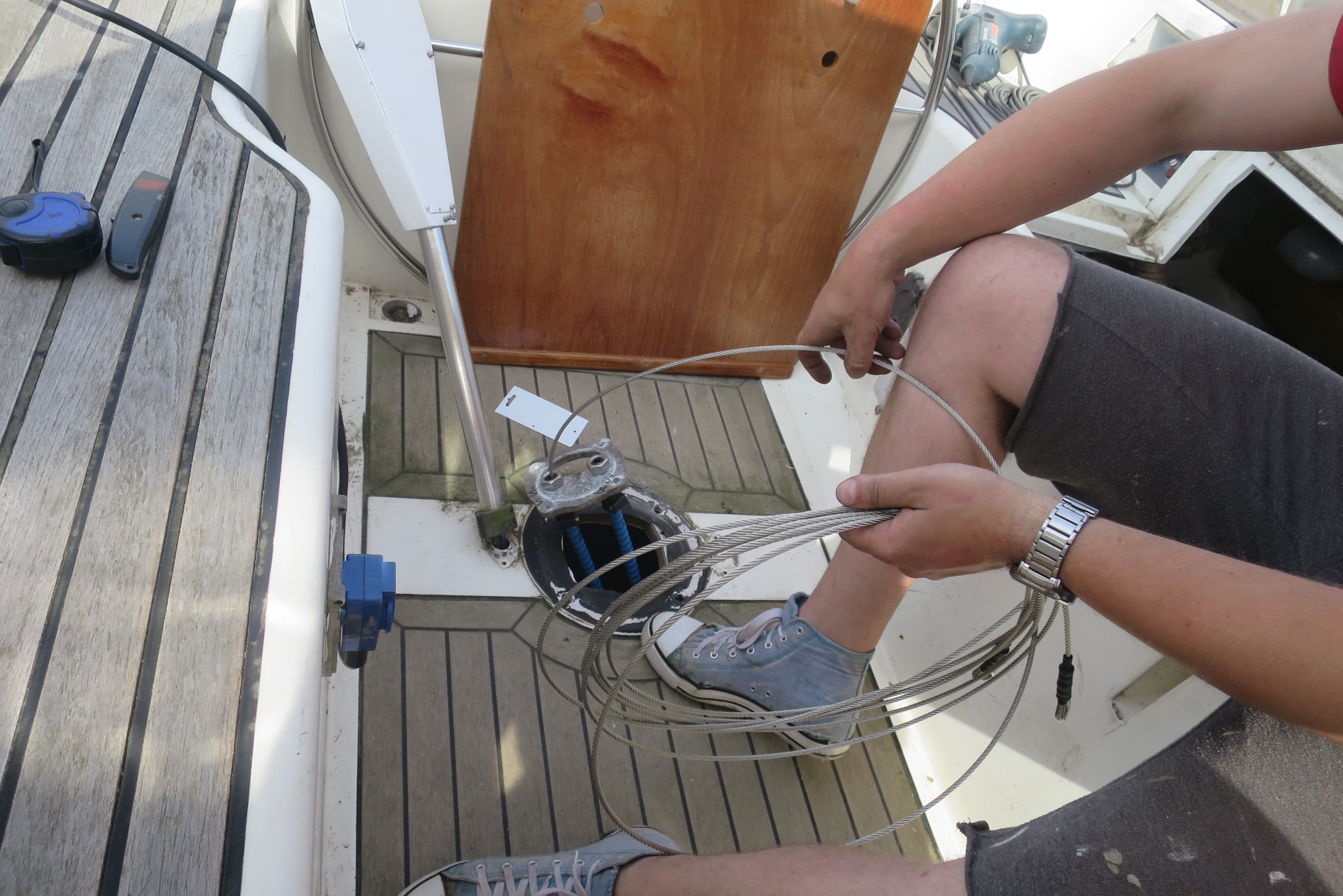

Hi Erik,
I'm interested! I need to replace my old red conduits on a Moody 422. 10m should be enough, right? The cables seem in good condition. Would I need anything else other than the conduit. Maybe new fittings?
I'm currently in Italy.
thanks
Hello Arthur
In reply to your questions :
1. 10m seems enough to me, but please try and measure it, as I am not familiar with the lay-out on the M422. Would be a pity to cut off too short...
2. The cable is in good condition indeed. It is brand new and unused.

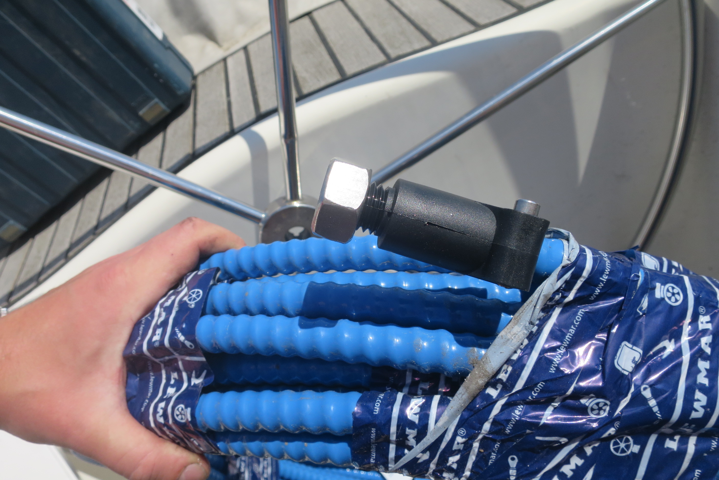

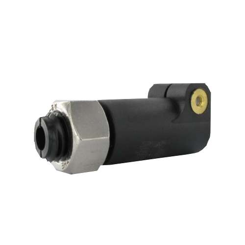

3. You might need new fittings. 4x identical.
89100116 CONDUIT FITTING 89100116. around 40pounds/45euros each.
I ordered them at Andy's in Plymouth, but I suppose any chandler supplying Lewmar parts can order them for you.
I have none.
I am joining some pictures of the fittings.

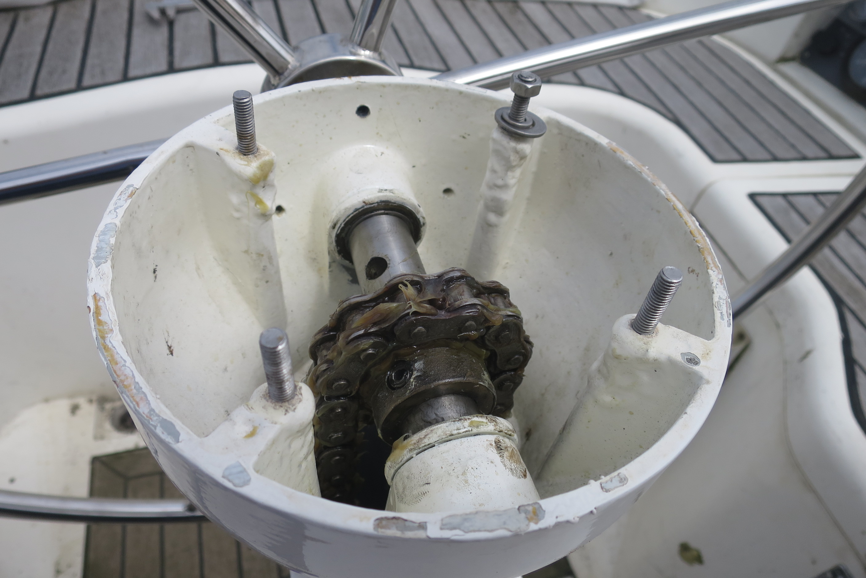

4. You might want to replace the inner cable, 5mm or 6mmØ steel cable. You may find it at any well equipped chandler's. Have him make eyes on one side (the side connecting to the little chain on the wheel shaft, under the compass). Make sure this eye is well done, when it gets loose, you have no more steering!
Take car the eye is not too big, as it needs to fit between chain wheel and the steering column, which is rather tight.
(see 4th picture, under the wristwatch)
5. If possible, I would prefer to dispatch to Italy or France (EU), rather than to the UK, avoiding customs hassle. And I would need to sort out which carrier delivers to the UK nowadays, not all do.
If you want to carry on, I suggest to settle details in a private mail.
Cheers Erik

Hi Erik,

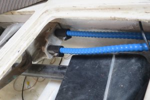

Thanks for the details. I'll try and reply to you by Sunday after I measure it all. I know there is a pulley at bilge level under the pedestal so the conduit needs to be cut for 2 sections and I'll need 8 fittings instead of 4.
Right.
I used a both simple and accurate way of measuring, by disconnecting one of the inner cables at the steering quadrant (on top of the rudder shaft) and pulling is out to the top of the pedestal, with a second line connected to it, so I could pull it back afterwards. It's just a suggestion. If you can reach all sections, you might as well measure alongside the conduit. It doesn't come to a couple of inches accurate.
